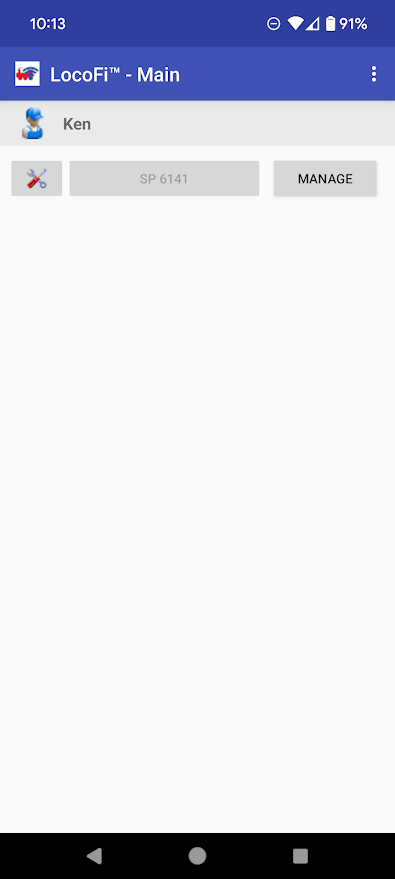

I am in the process of trying to debug a Version 3 install and having problems. As a check I put a successful prior install with a version 2 board. . I can connect to the Version 2 Board locomotive and ran a successful firmware upgrade. So I am connected properly. The engine responds to commands okay.
So I put the new install with a version 3 board on the track.
At first the new locomotive would show on the engine list. I went through the add cycle and the app responded that the engine was add and a temporary wifi connection was established. I then exited to the Main panel and could not see the new engine. I closed and restarted the app. The engine did not appear. So I recycled the app. I still did not see the engine but it was visible on add new locomotive. list and I ran through that again. It failed to add again not appearing on the main locomotive list. I tried it again. Each time adding the network password. This time it did not say successfully added and after recycling the app and clearing cache, it does not appear on the main screen or the add new locomotive scene.
I rechecked by running the good install and it comes up as it should. Is something in limbo. I recycled my router and tried again. The existing install works. I left it on the test track and put the new install loco back on the track too. I get a successful install for the new loco, but it does not show up on the main screen so I can complete setting it up. I tried recycling the app again and it does not show up. It show up on the add loco list again this time. This time I get a connect to network with temporary address. Again it does not show on loco list. once again it doesn't show up but is still on the Add Loco list. I seem to be in a loop. Note this is a diesel loco like the successful first.

Hello Ken,
Congratulations on the successful install of LocoFi 3.
To further assist you, can you please provide the following info:
1. What is the make/model of the smartphone/tablet you're using to add the loco?
2. What is Android version of the device, LocoFi app version installed and the locomotive firmware version?
3. Have you tried another device to add the loco to see if that works?
It would be great if you can provide the above info along with pictures/screenshots along the way.
Have you tried to connect directly to the loco and operate it? Since you have not been able to add it to your WiFi network, it appears that you are directly connected to it.
You typically don't have to do that.
Can you please elaborate more about the temporary address?
Couple of additional points to note:
1. You need to be on the WiFi network you want the loco to add to. Similarly, after adding the loco, you need to make sure that you are on the same WiFi network again you added the loco to. There are times when the smartphone might try to switch to another saved network and obviously you won't see the loco there.
2. Did you 'Forget network' before trying the 'Add Loco' operation? Although not an issue with newer devices, it is possible that some devices probably still exhibit this behavior.
- LocoFi Team
Further information
this is the test setup with the loco on the left showing up in loco list and new loco on right not.
Look closely and the existing install shows on loco list
list of wifi devices on home network showing new loco does not appear.,
