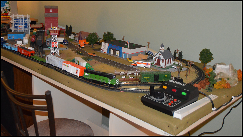

The autumn of 2016 rolled around, and I planned a new seasonal layout. This time, the baseboard was a lauan door that we had replaced during the remodeling and that had not yet made it to the landfill. It was approximately 7 ft x 3 ft, which provided more track and display area than the drywall panel of the previous year, i.e., 21 sq ft versus 16 sq ft. The party table was again the support for the layout baseboard.
By 2017, I realized that designing the track pattern by the trial-and-error method of placing physical track sections together on the baseboard and hoping that loops would close and so forth was time consuming and frustrating. Therefore, I downloaded open source track planning software from the internet to aid in the design of a layout. That software greatly improved the efficiency of laying down the track, an important consideration for my temporary layouts. Using the track CAD software was almost as much fun as building the physical layout.
About this time, I gave up on using the party table as benchwork, and I invested in a pair of folding plastic sawhorses with adjustable length legs. A plywood baseboard, which sat on a skeleton of two 2x4 spines and six 1x2 ribs on top of the sawhorses, replaced the lauan door. What happened to the party table? The adjustable sawhorse legs allowed the new style of benchwork to be high enough that the table could be rolled under the train display after the sub-board wiring was completed. The table was then ready to be rolled out should it be needed for entertaining.
Something to keep in mind here is that I had a seasonal craft. I had no plan to build a permanent layout. I needed to be able to assemble the benchwork, lay track, and build out scenery and trackside industry items in a smooth and steady process. I needed to be able to disassemble those same items in a similar manner. As an example, the benchwork pieces were fastened together with screws that were inserted and removed easily with my electric drill. The pieces were all drilled and marked, and I kept the screws in a plastic bag and stored them with the other layout hardware. Attaching the ribs to the spines and the baseboard to the ribs took no more than thirty minutes. I kept the wooden benchwork items organized such that they were easily stored from one year to the next. Items not in a long-term storage situation were readily available for other purposes. The folding sawhorses, for example, were easy to hang on ladder brackets on a garage wall, and they found various uses during the non-train seasons.
The power and control of the wintertime craft layouts were traditional analog DC. I knew of DCC, as I mentioned above, and I thought that digital control of my locomotives would be an interesting step forward at that time given my hobby and professional interests in electronics and computers. Through a local hobby store with a sizable model train department and seemingly knowledgeable staff, I investigated converting from analog DC to DCC. I was put off by the apparent entry level costs. In the process of conversion, I would have to purchase one or more DCC locomotives plus the AC power supply and the control unit. The cost to switch, depending on the options, quickly climbed above $300 and gained on $500. Basically, my legacy DC locomotives and powerpacks would become obsolete. To be fair, retrofitting one of my DC locomotives for DCC operation might have been possible and less expensive than purchasing a new DCC equipped locomotive, but, at the time, that was unknown territory for me.
